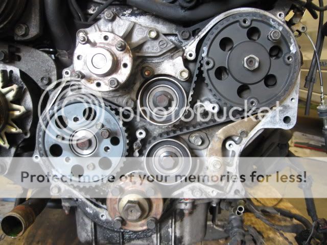

Found this pic on here somewhere.... and used that to align marks.
Cambo
Posts: 12
Joined: Mon May 27, 2013 1:39 am
Re: 2.8t 4JB1T problems
Post by Cambo »
1 thing I have noticed in the cam and injector pulleys is small arrows stamped into the pulley edges.
The cam arrow, when locked up in position, points down toward the crank at approx the 4oclock position. The injector pump pullet mark is also at approx the 4oclock position when the lock bolt is in place.
The manual I was using didn't show these marks at all.
Are they supposed to be aligning with anything?

I just looked at some pictures of when I had an engine out to do some repairs. Those small marks are in the same positions as you mention.....
Cambo
Posts: 12
Post by Cambo »
I have found a diagram for the timing marks from AutoData and it shows the lock bolts in the cam and IP pulleys in the 4 O'clock position.
Don't know if this is correct or not, but the Isuzu manual shows them in the 2 o'clock position and I'm more inclined to believe the manufacturer over aftermarket
info.
