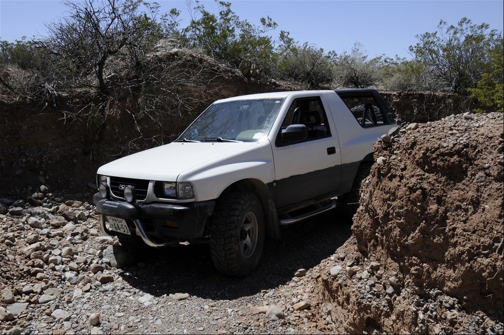

Bullbar: JDM Isuzu MU front and side nurf bars

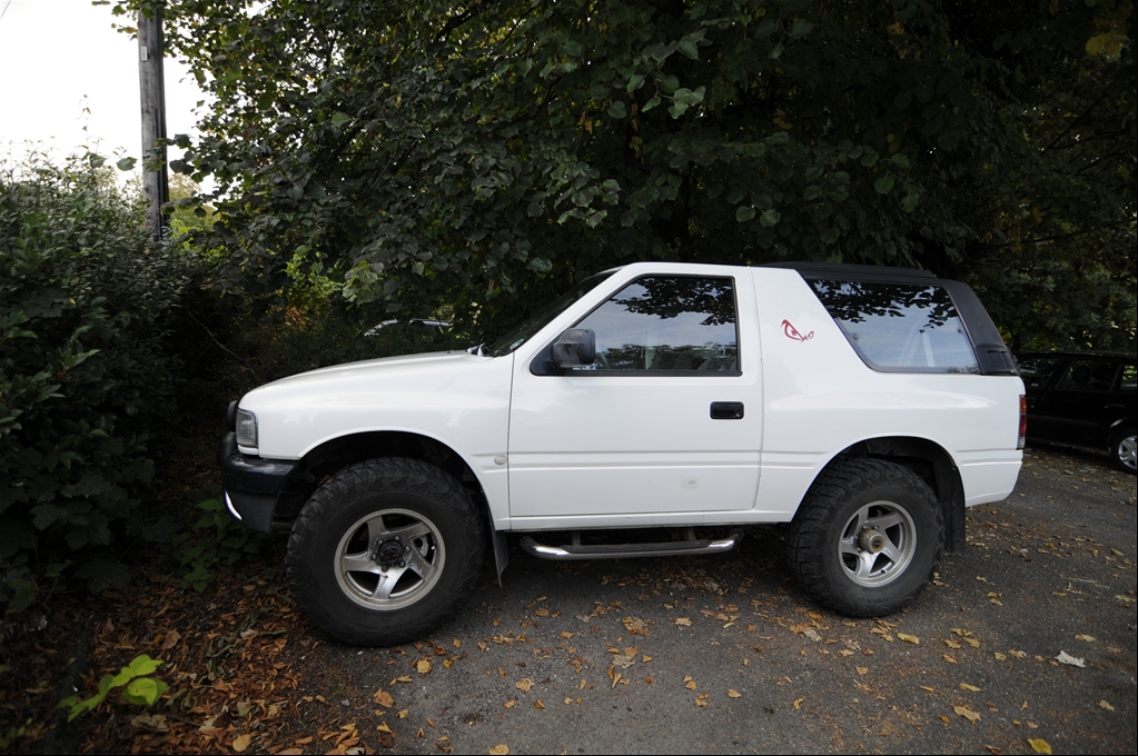

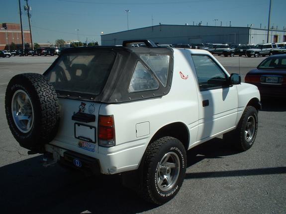

The Amigo as it had looked when I first got a hold of it. This was the day it was shipped from the US to the UK.

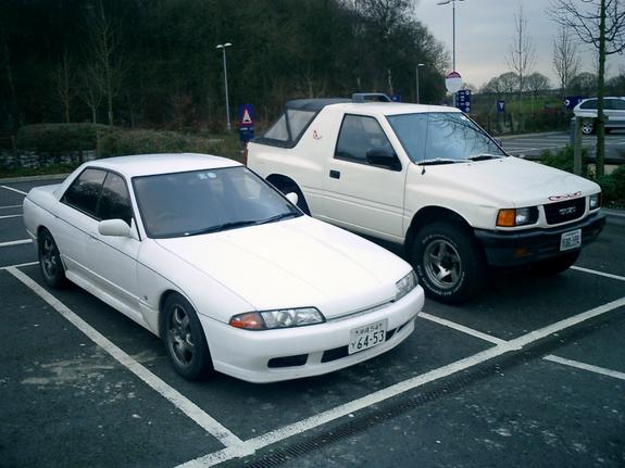

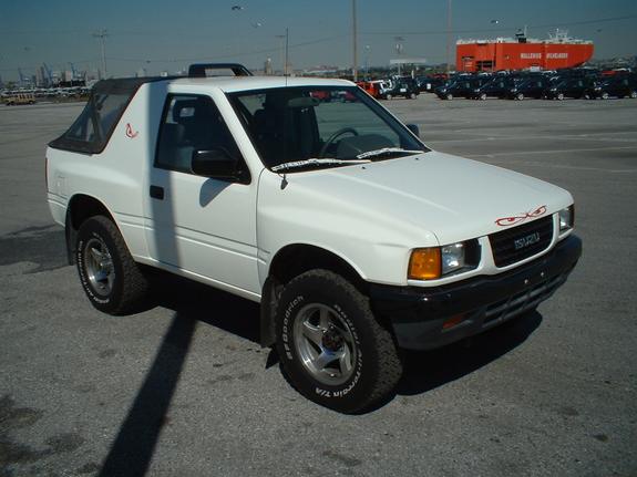

When it got to the UK, it was joined by the Skyline I had in Japan and brought to the UK as well.

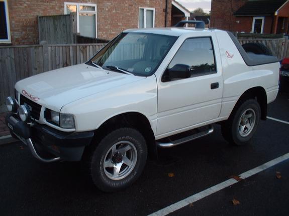

After arriving, I started putting on the Japanese MU parts I collected, starting with the front and side nurf bars.
Next was the MU hatchback style hardtop.

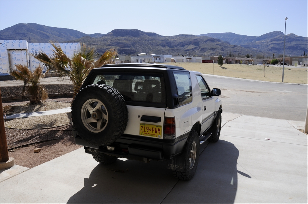

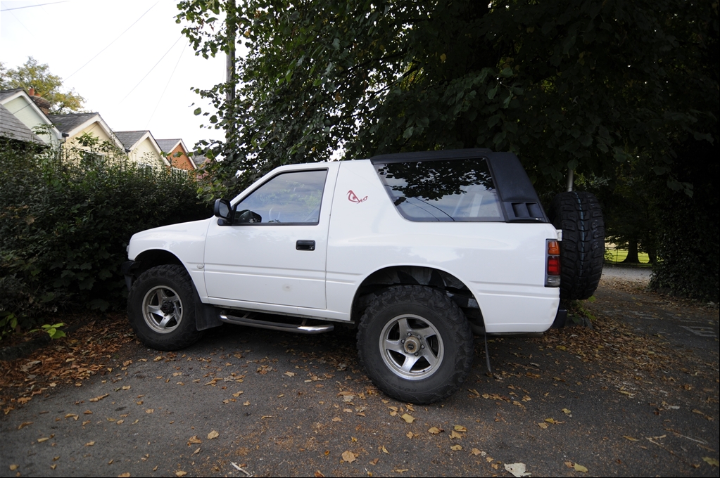

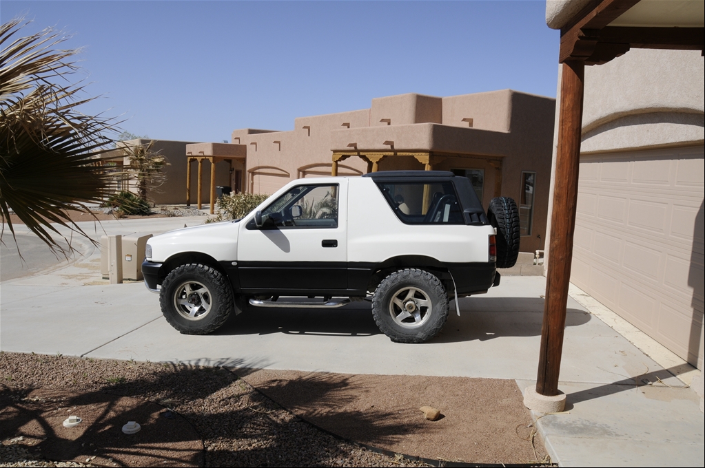

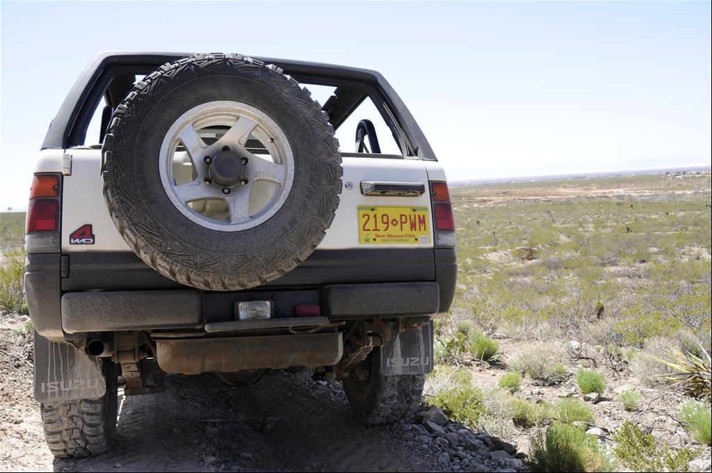

After a few years with that top, I wanted to have the rear seats and more cargo space available. So I got the hard top from the Isuzu licensed GM Vauxhall Frontera Sport. It's the most functional hardtop I've found. The top panel, side and rear windows can be removed.

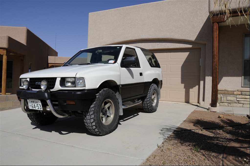

After returning to the US, it was time to fix rust spots on the lower parts of the door that it got from the UK weather. Once fixed I put truck bed lining from the body bolding down, something that helps anyways going through the brush on the trails.

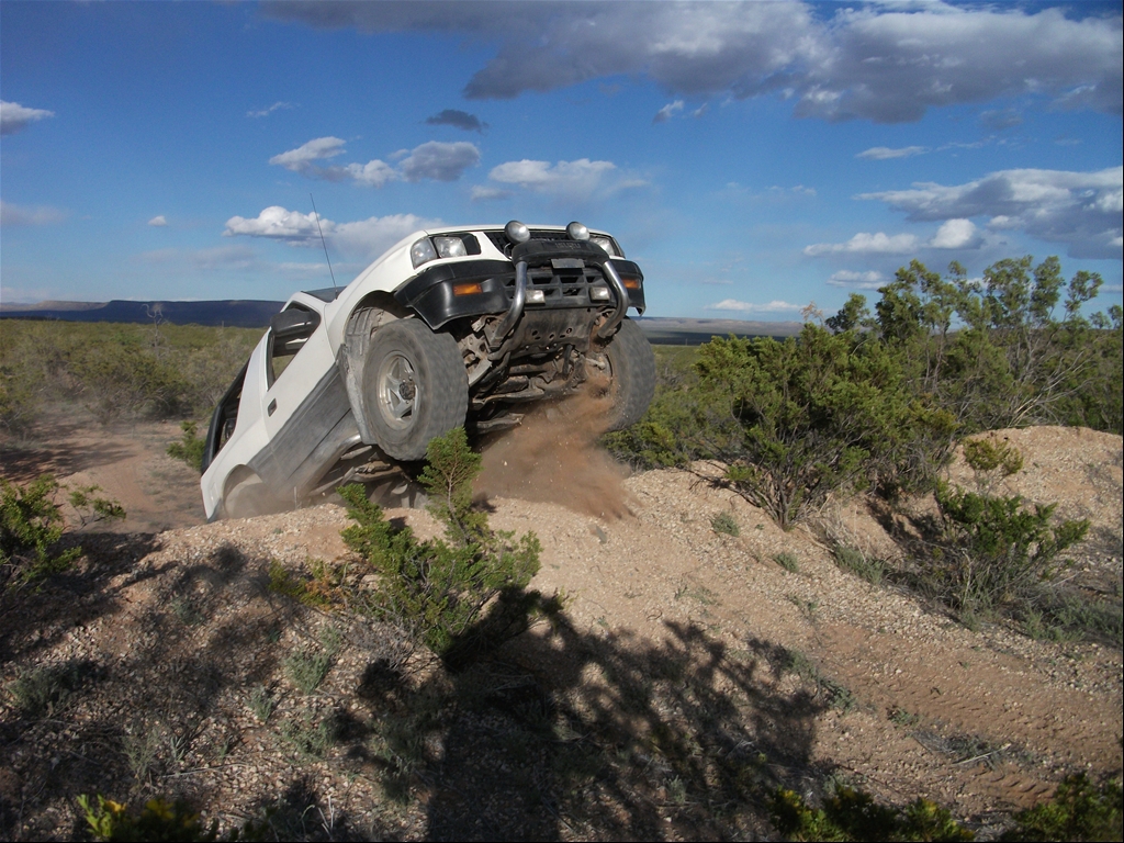

Now it's back at home out on the trails.
