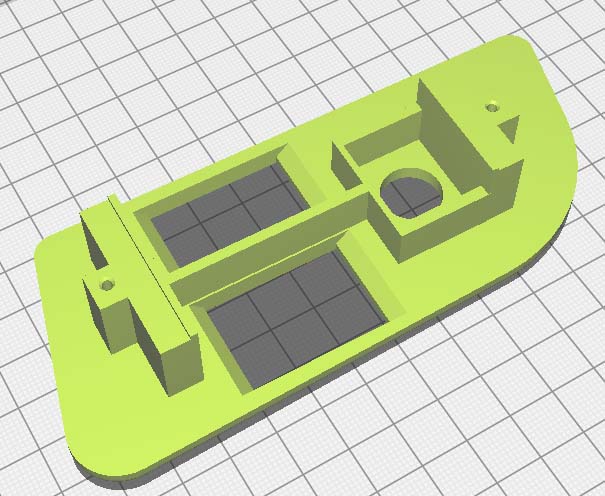

My window switches in the drivers door have over the years been giving issue going faulty every now and then. I then have to play with the internals and usually get the contacts to behave, but last time I just could not get them going, and replacement parts usually have the same issues being old.

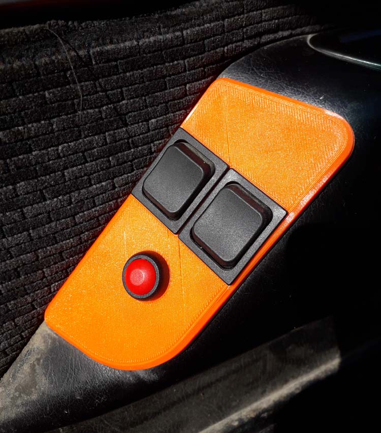

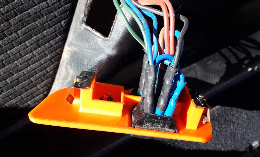

So I 3D printed my own panel and fitted some brand new switches.
It uses the original snap clips and fits the same as the original.
Also has a push button for rear window release I added.
Done in "all I had on hand orange", but would look better in black

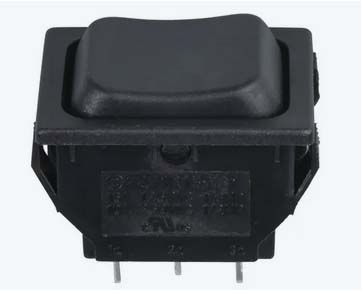

Jaycay SK0980
https://www.jaycar.co.nz/dpdt-switch-ce ... s/p/SK0980
